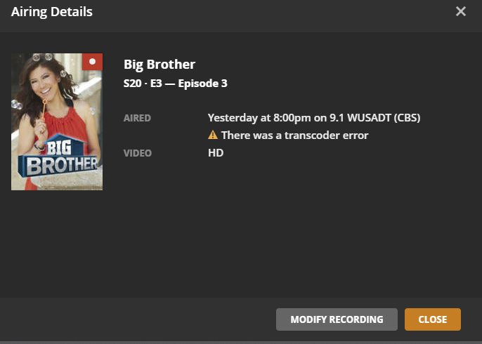

I recently setup Plex DVR and I keep getting “There was a transcode error” when it attempts a recording of a show. See screenshot attached:
Capture
I haven’t really done any advanced configuration here, so I’m not sure what is happening. As a test, I tried to record a 30min show last night and that completed without the error, but I do seem to keep getting this same, “There was a transcode error” when trying to record this program.

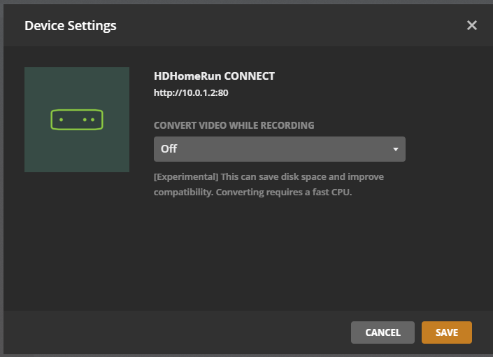

Also, I notice there is a feature “Convert Video While Recording” which is currently set to off. Should I try turning it on?

As far as the Convert Video While Recording setting that will force Plex to transcode any incoming mpeg2 video to h264, after the recording is complete. On a slower system this can cause recordings to take a long time to complete. User often referred to this in the past as the 100% bug. Recordings would stack up trying to transcode and when the Remove Commercials option was added also running the Plex Commercial Skipper process. User would literally see recordings for the entire day still processing. If you are going to use this option I would run some tests of 2 recordings Back to Back (B2B) across several hours and see how your system performsin the tests. With the new Grid View this is much easier to do. Testing Alpha releases used to be a real pain when trying to setup B2B recordings across my 6+ tuners and covering times from 8:00 am - 5:00 pm so they were done before any evening recordings were scheduled to start. But we need to first get you to being able to record a full hour long show.

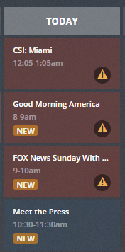

Right on and you were correct in that re-adding the device had no effect. 3 out of the 4 random recordings I picked on different networks last night failed:
