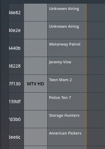

I have just tried them again and Plex will not pull in the “limited 5 day” feed for me to check its accuracy. The “All 48 hours” works, but looks like this (so not great).
01
I personally am Freeview OTA (Meridian), so the “always correct” master source for me is:
https://awsbrain.freeview.co.uk/meridian...
