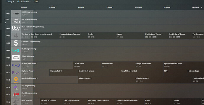

I am now looking at an EPG where a lot of channels (BBC1, BBC2, ITV1 etc) are just showing BBC 1 Programming etc.

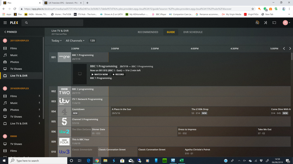

Whilst there may be different problems lurking here, I’m seeing a repeat of the problems that were cured in the EPG data a week or so ago, namely the guide looks OK from iPhone / iPad but from the web interface it’s showing “Channel Name” - programming. I believe Plex cured this by purging the EPG stream on the " Freeview-National Lineup United Kingdom OTA Broadcast" feed by purging some weird 24 hour entries that each different client platform was displaying differently - iOS devices OK, web interface wrong.
This is happening again right now.
It would be good if we could have fixed problems remain fixed !!!
@sa2000 thanks for your message and advice. I’ve looked at my iOS clients and they do show programmes but the server / web interface doesn’t, and as a result the recordings for those channels aren’t taking place. It looks like the 24 hour issue you suggest but is still persisting after many guide refreshes and DVR deletes/re-creates. It looks like everyone using the DVR in the UK has this issue right now?
UPDATE. if I access the a Guide on my iPhone or iPad, all programmes are there and look normal. None of the e.g. “BBC1 Programming” messages i am seeing on the web app.

BBC1 shows ‘BBC 1 Programming’ for the next 9hr 2 min on the guide

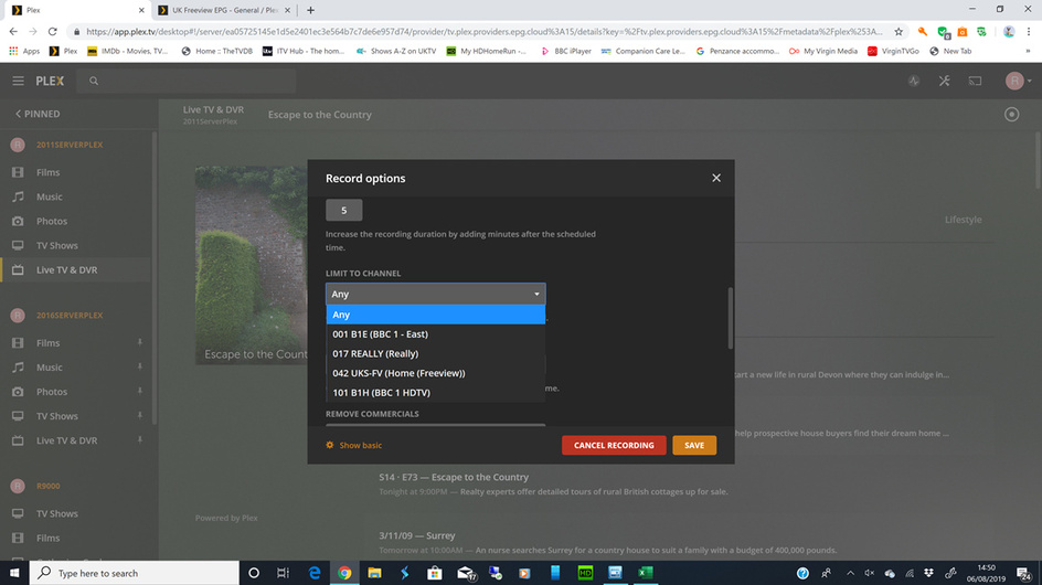

However, I have successfully scheduled ‘Escape to the Country’ which is on BBC1 today from 14:30-15:30
The only conclusion I can draw from this is that the schedule data is there, but is being incorrectly displayed in the guide i.e. a change to Plex such as the recent altered Home page is the culprit rather than poor EPG data from TIVO.
