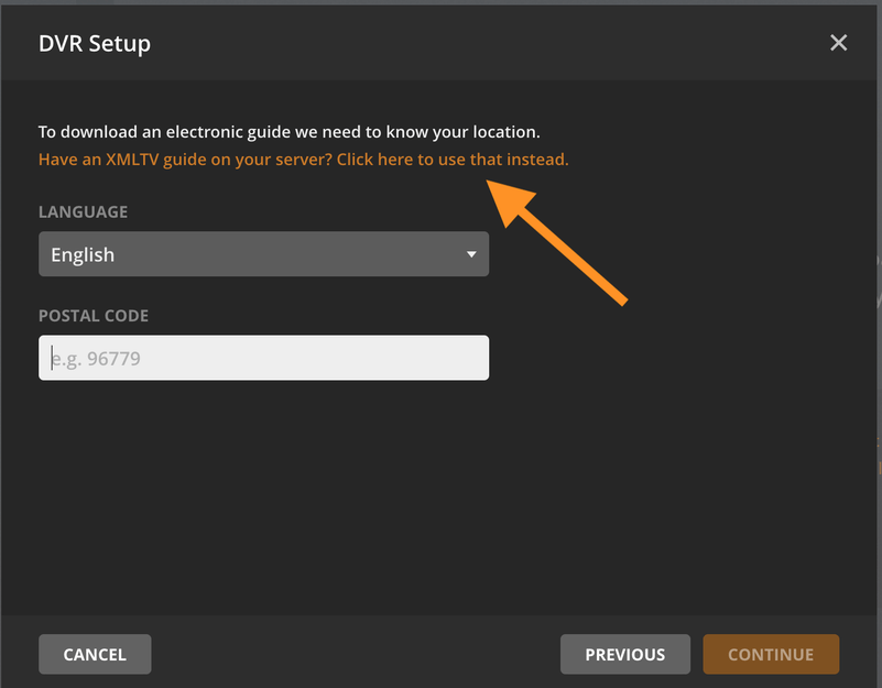

When you set up a DVR you can choose to use XMLTV
https://support.plex.tv/articles/225877347-live-tv-dvr/

You will have to delete the DVR and add it back selecting the XMLTV option. Guide data comes from Gracenote. Recordings already scheduled will not be deleted when you remove the DVR so no worries about setting up the recordings again if you switch the guide used to the XMLTV.
