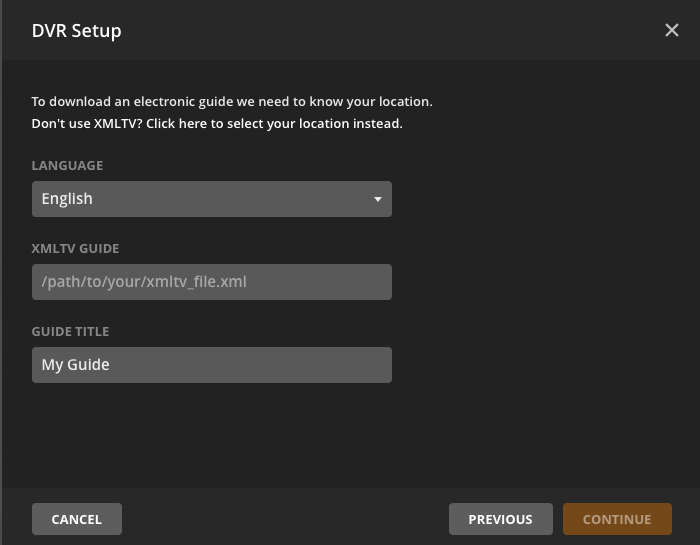

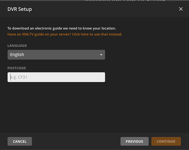

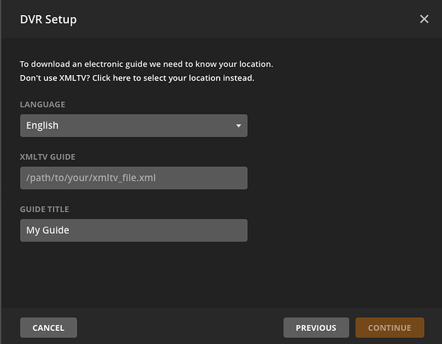

I am a Perl novice - I think I can attempt this in Windows 10 - being new to Plex as well, how will I get Plex to access the generated guide if the Plex server is set up on the Nvidia Shield TV? Do I run Perl scripts on the Shield?
I don’t have a Shield, but you can run the Perl script on your PC and (should be able to) have Plex point to the output file (assuming your Shield can see your PC).
When adding your DVR (if you have one, you’ll need to delete it first), you’ll eventually get to this screen:
Clicking on the Orange link will reveal an extra field where you can input the path to the file (on your PC).

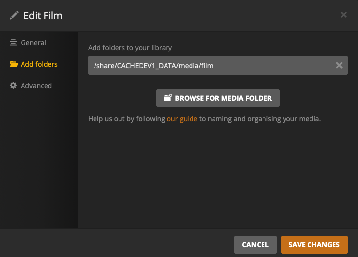

Thanks - I managed to generate the xmltv file and I moved it to the Plex Media Server folder on the Shield but no luck so far in specifying the path correctly in the DVR Setup page. Will google this further.
Editing one of your libraries might help you understand how the Shield’s folder structure / naming convention etc. works. Here is a snapshot of my QNAP NAS for example…
On my Mac, it looks like //<server-name>/media/film but I know these two things are essentially the same.

Thanks for the tip - that works. Strange enough, need to add /sdcard/… in front of the path. But HDHR seems not to be picking up the HD channels like ABC HD and SBS HD - I wonder if this is related to the slow Ethernet connectivity …as the powerline connection is not great. Live TV is also pixelated and unwatchable. So many variables to fix!
