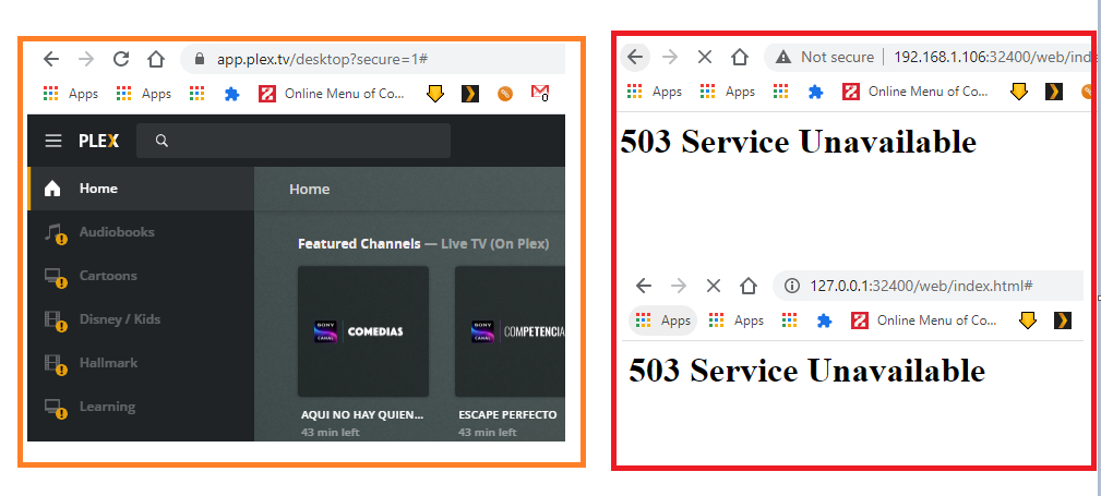

Happened again. Nothing in Plex is accessible on any IP as shown. App.plex.tv shows all offline, and 192.168.1.106 / 127.0.0.1 just give 503 errors. It’s not an issue with internet / port forwarding.
pms stayed in system taskbar by clock as if it was running

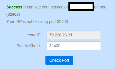

port stayed open/unblocked
*couldn’t * access server settings + all folders appear offline
Nothing I tried fixed it besides "Right click PMS by clock, “Exit”, and re-launch of it…
Error 503 is indicative of a deadlock and requests queuing up and then when we reach over 4000 queued unactioned requests we start to return error 503
For deadlocks one would need a Plex Media Server process dump and logs zip and list of all the connections at the time of the deadlock.
