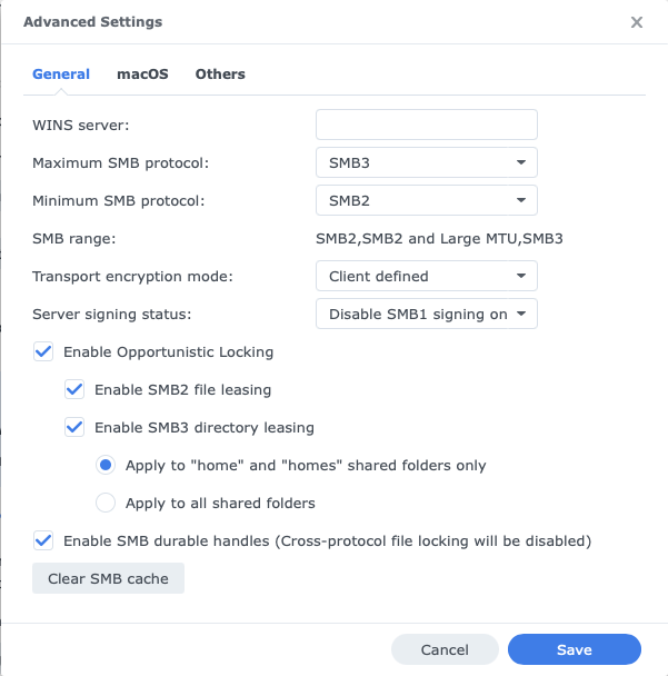

In the Synology NAS, you have to put these values in the advanced settings of SMB:
No disconnections, no trashed items, stable connection (with Automounter).
It simply works!

Completely anecdotal here, since it seems the “fix” is all over the place. But these are my Synology settings, with the conf file being set the way it was provided, and mine has been working without issue since the conf file was provided… so about 4-5 months?

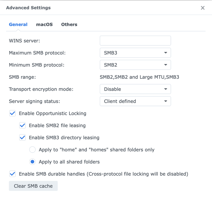

My Synology configuration:
Without packet signing. For me is rock solid, 3078 movies in library and 527 TV shows. For me is working without any issues.

After seeing these configuration screenshots, I gave it another try at my end, removed the tweaked nsmb.conf (once again) and enabled the SMB3 directory leasing option - and that seems to have solved the issue, here. Three days without anything moved to the trash (No AutoMounter).
I confirm that: Empty nsmb.conf, and SMB3 directory leasing enabled seems to work fine! I use AutoMounter.
I think MacOS 15.5 + SMB3 directory leasing resolved the issue.
Checked my Synology settings and I can also confirm that these settings work without nsmb.conf present. Been working fine for more than 2 weeks now.
