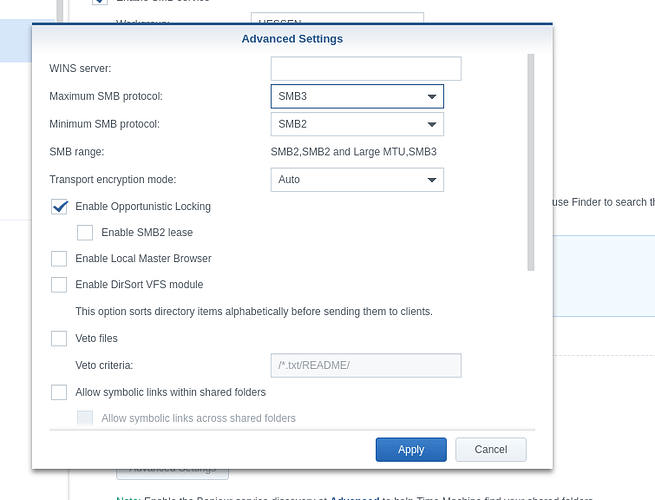

Windows is your bottleneck. SMB 3.0 to be specific.
While windows might do SMB 3.1 or even higher, Synology is stuck at SMB 3.0
This limits you really badly to the practical limit of about 35 MB/sec on a 1 GbE link. It’s a horrifically bad protocol and only SMB 3.1 can really help out.
Just to check the boxes, here is how I have SMB configured even though I don’t use it ( I am entirely NFS )
You are correct that Jumbo frames will help a bit with SMB 3.0 (35 MB/s/session max) for bulk tranfers but wow. A great deal of pain for so little gained when 1500 MTU on SMB 3.1+, NFS or AFS screams along at wire speed.

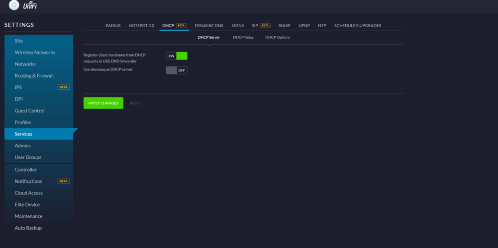

I don’t use proxy but I use ubiquiti usg router.
I did some research online. Some says to add set service dns forwarding options rebind-domain-ok=/plex.direct/
I am struggling to find the place to add. Not sure whether you may tell me…
I’m sorry but I use pfSense.
Your best source of an answer there is either their forums or support manuals
