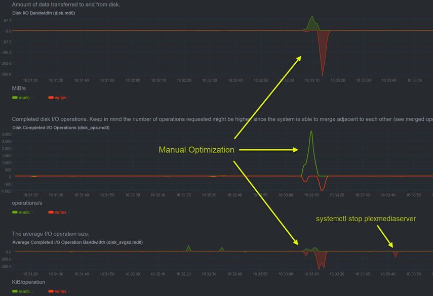

“Also, have you performed manual optimization of the database ?” I hadn’t, but after your post I did, it made no difference in the stop hanging and getting killed.
“It sounds like the server is taking longer than normal to flush / write all the transaction data (fragmented DB is the most likely cause)”. The database (actually the whole server) is on mirrored NVMe storage. If this were the case the system should be doing some IO in that minute and a half and I don’t see very much CPU or DISK activity in netdata.
I can confirm that rolling back to 1.21.4.4079 fixes that hang.
Here’s the section of the graphs from netdata during each action.
Disk IO:
CPU:
Not that it helps, but this does confirm that prior to the update shutdowns or plex stops had no delay, but I looked back in my syslogs and found another entry, looks like I updated the server and rebooted for a new kernel. The logs show there was no wait on the shutdown of plex.
