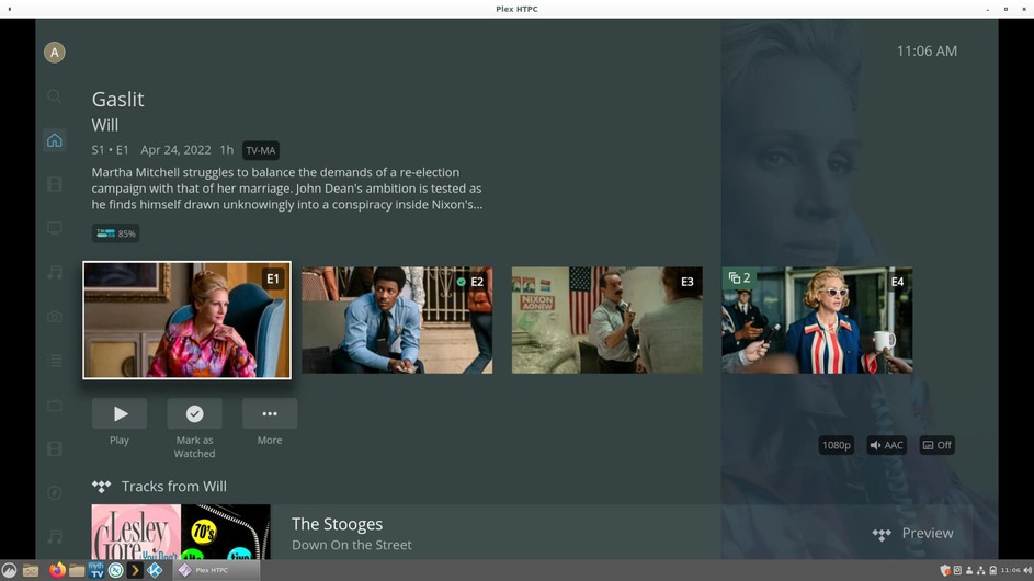

When I first installed plex-htpc last week went full screen (Linux), which was nice… ![]()
When I started it up yesterday it went to a windowed mode and now there seem no way to fully maximise it when playing videos.
The header and footer desktop panels are always visible,
I can’t find a menu item to set full screen. Is there a keyboard short cut or something else I should be aware of to get videos to play full screen?

Never mind. Found it,
My brain couldn’t process that MAXIMISED <> FULL SCREEN
