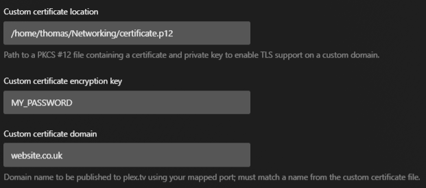

And here is what my PMS config looks like:
I have restarted PMS and I still get the error:
