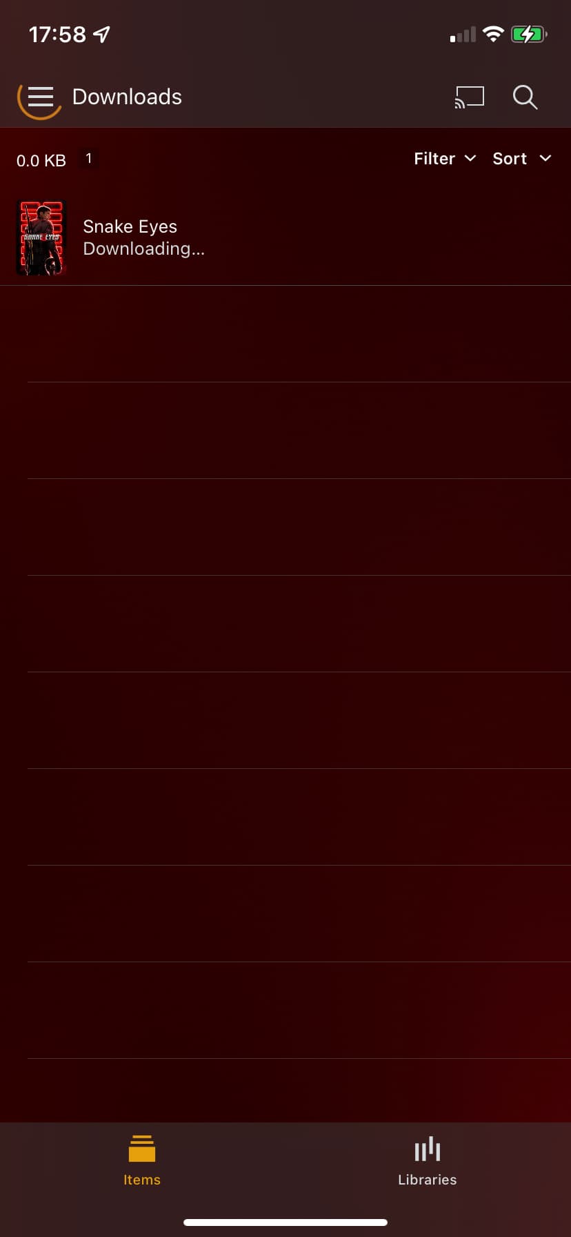

I have been having what I think is a similar issue. I have been through the process which was described above. Cancel all sync items, enable downloads, force close app, reload (to make sure the settings change happened) and then initiate one download.
This shows in the app (a download, but appears to be stalled).
I then looked on my server, and realised it is transcoding…

As a feature improvement would be really nice to actually see somewhere the progress for the transcoding (not found that anywhere yet), and I am not sure if this will actually download once transcoded (not had any success with the feature yet).
I will update later when I’ve left enough time for the transcode to finish.
You can check the download progress on your phone app by going to the downloads after you select it to Download. This will give you a progress circle. It doesn’t tell you if it is transcoding or downloading, but provides the overall progress.
FWIW…transcode is way too slow for me so I’ve always converted my videos to codec and file type that’s direct play. It makes the overall download process MUCH faster, and saves on processor demand.
