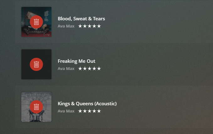

Plex is deleting items off the Plex Server
Server Version#: Version 4.56.4
Player Version#: Version 4.56.4
PlexAMP
Would be good to know where they are being deleted to so that I can restore them.
Many of which is removed from my external hdd, - why is this the case?

David
Its appears to be a hdd failure… that rellocating sectors…is the issue…
Thanks,
I think i have that setting enabled, despite its an external hdd. CrystalDisk Info reveals “Caution” on the hdd, so I guess its that rellocating sectors error is causing all these being deleted.
I will try again with a new external hdd once i get it.
