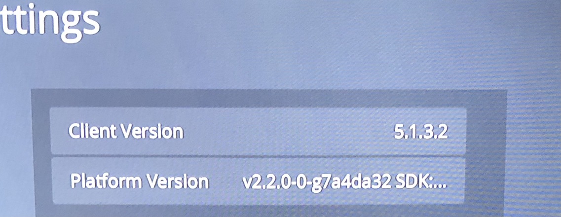

Ok some I made those changes as I stated above, still, get this error on plex on the PS4 app (preview)
I have closed the app and then I go back into and it works, but sometimes it doesn’t.
Any thoughts on this?
This is a photo of what happens below.
