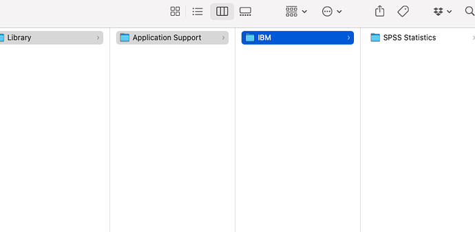

which db file were you repairing or restoring from ? exact path please - screenshot of the folder contents you were working with
In the application support path there is no folder for Plex Media Server (see screen shot-1) I erased the com.plexapp.plugins.library.db file inside the Plex media server application (see screen shot-2)

The folders/files are hidden - Access to the application data files is mentioned in this article
Where is the Plex Media Server data directory located? | Plex Support - for Mac OS it says
Using the Finder’s “Go” menu, select Go To Folder… then enter the following in the dialog box that pops up:
~/Library/Application Support/Plex Media Server/
