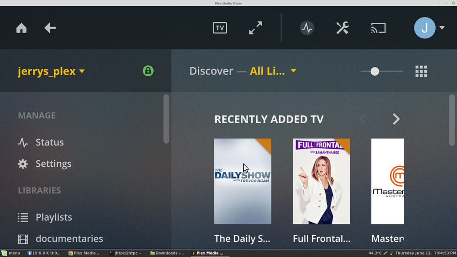

biiig long thread so the answer might already be in here… apologies if so.
I’m just testing this out for now since i’m getting errors on playback when using the chrome web viewer.
First question, why does it look so scaled up?
We’re using a linux box plugged into a TV via HDMI.
(edit: this is using the latest appimage. i tried installing the proper thing, it installed, but now i can’t find any way to open that! doh!)
Thanks!
(edit again: have found the ‘tv’ button, but the icons are still huuuuuuge. It feels like I’m using the visually impaired version :crazy_face: )
