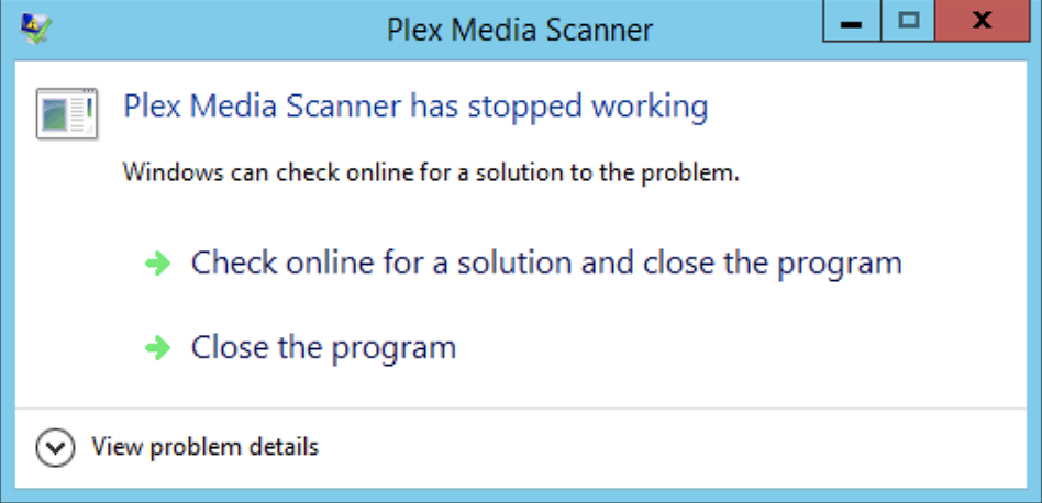

I’ve been having Plex Media crashes every night as well. Running Windows Server 2012r2 with latest Plex Bata. I have included Plex logs and photo of error.Plex Media Server Logs_2018-11-29_15-37-24.zip (3.7 MB)
48%20AM
Here are the ā€œProblem Detailsā€
Problem signature:
Problem Event Name: APPCRASH
Application Name: Plex Media Scanner.exe
Application Version: 1.14.0.5470
Application Timestamp: 5bf7f714
Fault Module Name: StackHash_1530
Fault Module Version: 6.3.9600.18895
Fault Module Timestamp: 5a4b127e
Exception Code: c0000374
Exception Offset: PCH_01_FROM_ntdll+0x0003C8AC
OS Version: 6.3.9600.2.0.0.272.7
Locale ID: 1033
Additional Information 1: 1530
Additional Information 2: 1530f42351bb27b24585fc424788c62c
Additional Information 3: 8f06
Additional Information 4: 8f06ab6ef1c6932d6d79b35447332ad2
Read our privacy statement online:
http://go.microsoft.com/fwlink/?linkid=280262
If the online privacy statement is not available, please read our privacy statement offline:
C:\Windows\system32\en-US\erofflps.txt
Did you mean to provide logs that are 2 weeks old?
Your post is dated 12th December. Your logs are from 29th November.
Regardless, for scanner crashes we need to identify the file that is getting the crash when scanned. So what would be important is capturing logs that include scanner logs for the time of a crash.
You will see from earlier dialogue in this forum thread that this is not easy and would most likely need increasing the number of log files and also making the registry changes to get windows to produce the dmp files for the crashes.
Go through the earlier dialogue in this forum thread and follow the advice given. Need to capture scanner and scanner analysis logs that cover the times of the crashes in the application event log
Just to help users that have Windows server and are getting these crashes I was able to fix the problem by installing Windows Server Media Service via Rolls Manager. I also installed Windows Server Essentials Media Pack from the Microsoft website and the errors completely cleared up.
