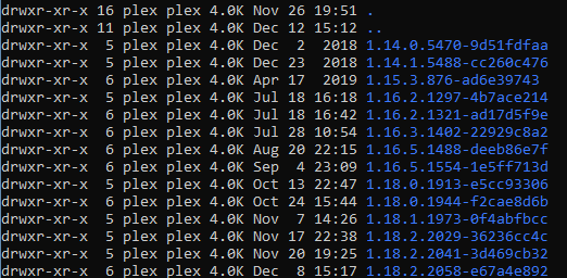

there is a few listed, looking at the dates there’s noting from today:

I have the exact binary, exact symbol table, and your dump file. 1.18.2.2058
It keeps telling me I have the wrong version.
This IS 2058 ?
