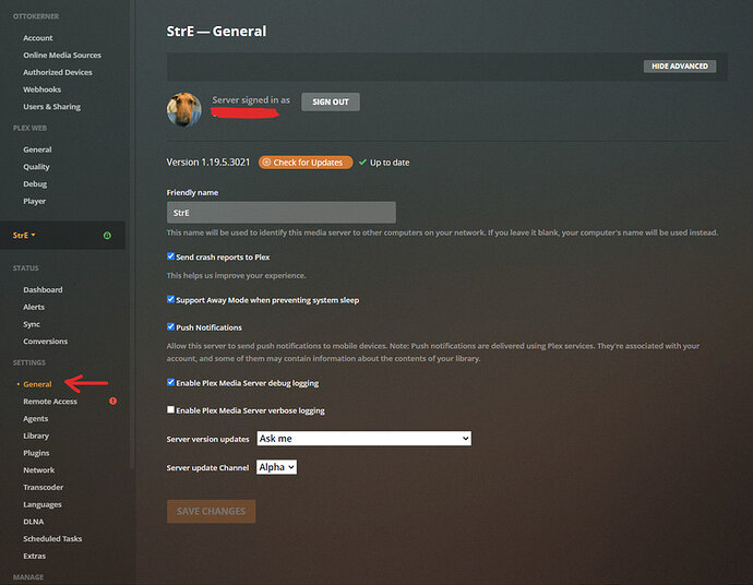

You need to enable debug logging, if you want to see useful things in the log.
The above errors can be safely ignored.
  1. activate debug logging (not ‘verbose’!)
  2. quit Plex Server
  3. wait 1 minute
  4. start Plex Server
  5. wait 5 minutes
  6. fetch log files and attach them here

You did not turn on the server debug logging.
You probably acitvated it for the web app, which is a separate thing.
That explains why the console didn’t show anything… a web search put the “Web App Logs” on top.

Yes, but now you leave the debug logging on. If the issue re-occurs, there is a chance to see what it actually does in the logs.
