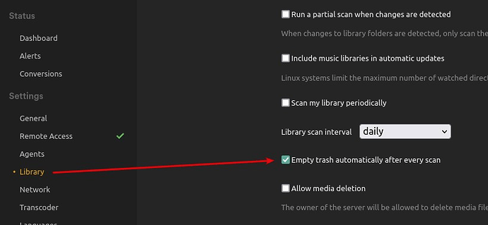

Are your media files on an external drive or NAS? The most common cause of issues like this is that the external device doesn’t wake up quickly enough when Plex begins its routine scheduled scans. Since the drive isn’t awake, Plex sees the media files as gone, and removes those items from the libraries.
The fix for this is to turn off the “Empty trash automatically after every scan” option in the Library settings:
