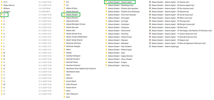

Hi all, I have a WD PR4100 NAS with Plex media server. all goes well for movies and series, but my music library scan is taking too long and after a while plex server stops responding on the web interface and i can’t see logs/settings etc… but it seems like the scanner keeps running on highest speed!
I have many (1.TB / 201.349 files) *.mp3 & *.jpg files within the music folder, with an perfectly arranged folder structure and naming standards.
There are no *.zip / *.rar / *.tmp / *.bad files within this folder available
Any idea how I can fix this? Or is this amount of files just to much for plex to handle?

Attached the folders & files structure screenshot… is almost same for all library:
