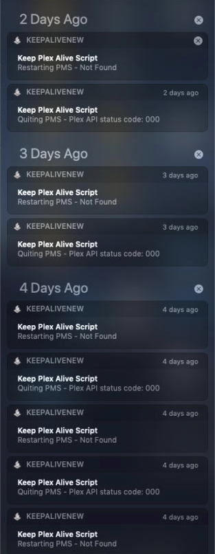

still happening for me too; its daily and my script catches it and restarts plex for me… but the particular movie thats causing the hang/cpu load/crash remains a mystery unless someone tells me it doesn’t work as there is no log of the issue as playback can never start…
Screenshot 2024-01-18 at 10.13.09 AM
(note: api status code: 000 means there was a timeout and the plex api is not responding)
