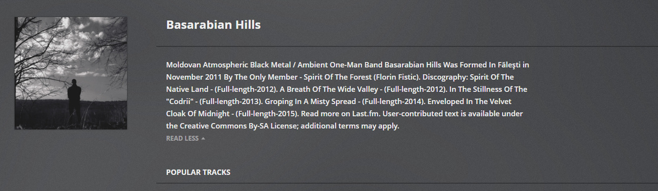

Example 2: Basarabian Hills (matched to MDBI: d0aaa9d1-53f9-4772-a63a-1820975c2ea5) has biography and band picture. The MBID also has no allmusic link to it, so unsure where this is pulling from? This is the same bio as last.fm and top picture, but there is no last.fm link supplied on the MB entry.
These are taken after i removed my old agent library, cleared trash and bundles, and rebuilt from scratch
Both artists have been updated well before 36 hours ago
Any thoughts?
If both allmusic and last.fm links are missing from MB, Plex will go out and lookup info on last.fm on its own.
So your results are expected.

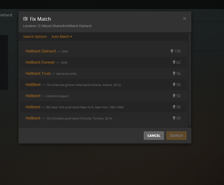

Another error I noticed, bands added to musicbrainz (who do not have Allmusic data) are not matching at all, despite being found by the agent (example being used is Hellbent Diehard):
Found via “Fix Match” after being added to Musicbrainz as per KB
Error on front end

Oct 20, 2019 11:57:57.967 [2432] DEBUG - Request: [127.0.0.1:62095 (Loopback)] PUT /library/metadata/357571/match?guid=mbid%3A%2F%2Ff4237ba4-d79a-43e7-b286-953b9ade4beb&name=Hellbent%20Diehard (10 live) GZIP Signed-in Token (destroy_musick)
Oct 20, 2019 11:57:58.140 [2432] ERROR - Music: Processing match for GUID mbid://f4237ba4-d79a-43e7-b286-953b9ade4beb failed.
Oct 20, 2019 11:57:58.141 [12756] DEBUG - Completed: [127.0.0.1:62095] 400 PUT /library/metadata/357571/match?guid=mbid%3A%2F%2Ff4237ba4-d79a-43e7-b286-953b9ade4beb&name=Hellbent%20Diehard (10 live) GZIP 173ms 463 bytes (pipelined: 33)
