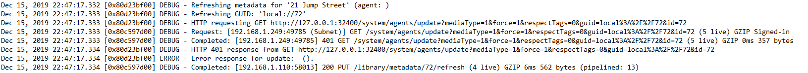

I opened logs and found HTTP 401 errors during searching for metadata. I added 127.0.0.1 to non-authorized hosts in plex settings but that didn’t help.
Jail in which i have Plex Media Server has internet access - I can ping imdb.com or 8.8.8.8
There is a full log - i tried searching for metadata for a movie at Dec 15, 2019 22:47

Ok, added 192.168.1.249/255.255.255.255 to non-authorized and now everything seems to work fine.
