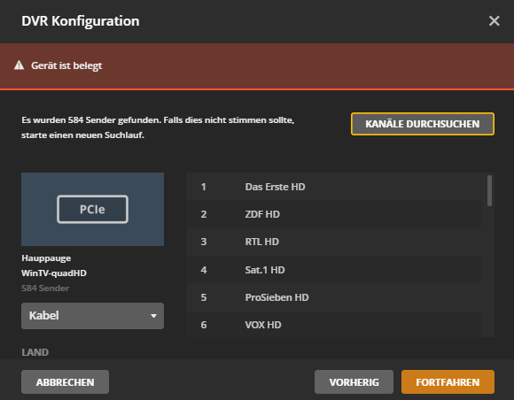

I deleted the DVR and tried to setup it again. Even with a deleted DVR the tuners are occupied:

The Plex instance was running around the last 24 hours with deleted DVR settings. Right now I tried again to scan the channels and the tuner was still occupied. However, after closing Plex and restarting it again, the tuner was available. So it seems for me that Plex is blocking its own tuners, even after removing the DVR.
