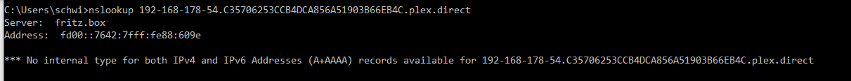

And does this now work in command line window on a machine on the local network?
nslookup 192-168-178-54.C35706253CCB4DCA856A51903B66EB4C.plex.direct
It needs to show resolved to 192.168.178.54
No. Same message. Interesting though, on my Pixel 6 Pro, Download works when i’m on the road but not when i’m on local WIFI/LAN. Is that what you said in the other post that only the DNS requests from within the same network get denied? Or is there something else going on?
