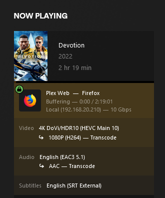

I’m setting up a Plex Server for a friend. The system is an Intel NUC 11 which supports Intel Quicksync. Plex is installed natively in Debian 11 but when I try transcoding, hw transcoding is not working as shown in the dashboard screenshot above.
I have the same setup but with a NUC 10 and everything is working. @ChuckPa do you have any ideas?

Thanks for the logs.
Your server logs (sorry for not being specific) show you’re getting HW transcoding
Feb 01, 2023 14:02:36.301 [0x7fdf3a7d5b38] DEBUG - [Req#3c3/Transcode] [FFMPEG] - Direct mapping possible.
Feb 01, 2023 14:02:36.301 [0x7fdf3a7d5b38] DEBUG - [Req#3c3/Transcode] TPU: hardware transcoding: final decoder: vaapi, final encoder: vaapi
Feb 01, 2023 14:02:36.301 [0x7fdf3a7d5b38] DEBUG - [Req#3c3/Transcode/JobRunner] Job running: EAE_ROOT=/tmp/pms-f7ed3182-6518-4746-a7eb-0180ff7837ff/EasyAudioEncoder FFMPEG_EXTERNAL_LIBS='/home/plex/Library/Application\ Support/Plex\ Media\ Server/Codecs/acf6c67-4446-linux-x86_64/' LIBVA_DRIVERS_PATH=/usr/lib/plexmediaserver/lib/dri OCL_ICD_VENDORS="/home/plex/Library/Application Support/Plex Media Server/Cache/CL-ICDs" X_PLEX_TOKEN=xxxxxxxxxxxxxxxxxxxx4357-8e93-cf70064a195c cl_cache_dir="/home/plex/Library/Application Support/Plex Media Server/Cache/Shaders/icr-9-linux-x86_64/" "/usr/lib/plexmediaserver/Plex Transcoder" -codec:0 hevc -hwaccel:0 vaapi -hwaccel_fallback_threshold:0 10 -hwaccel_output_format:0 vaapi -hwaccel_device:0 vaapi -codec:1 truehd_eae -eae_prefix:1 5c7vkrng5ezplutf1pxtat5q_ -analyzeduration 20000000 -probesize 20000000 -i "/mnt/data/media/movies/Black Adam (2022) {imdb-tt6443346}/Black Adam (2022) {imdb-tt6443346} [Remux-2160p][DV HDR10][TrueHD Atmos 7.1][HEVC]-playBD.mkv" -filter_complex "[0:0]hwupload[0];[0]scale_vaapi=w=2276:h=1280:format=p010[1];[1]hwmap=derive_device=opencl[2];[2]tonemap_opencl=tonemap=mobius:format=nv12:m=bt709:p=bt709:r=tv[3];[3]hwmap=derive_device=vaapi:reverse=1[4];[4]hwupload[5]" -map "[5]" -codec:0 h264_vaapi -b:0 20000k -r:0 23.975999999999999 -force_key_frames:0 "expr:gte(t,n_forced*3)" -filter_complex "[0:1] aresample=async=1:ochl='stereo':rematrix_maxval=0.000000dB:osr=48000[6]" -map "[6]" -metadata:s:1 language=eng -codec:1 aac -b:1 256k -f dash -seg_duration 3 -dash_segment_type mp4 -init_seg_name 'init-stream$RepresentationID$.m4s' -media_seg_name 'chunk-stream$RepresentationID$-$Number%05d$.m4s' -window_size 5 -delete_removed false -skip_to_segment 1 -time_delta 0.0625 -manifest_name "http://127.0.0.1:32400/video/:/transcode/session/5c7vkrng5ezplutf1pxtat5q/97df1446-3838-4cb4-91b3-40c7e62f2dcd/manifest?X-Plex-Http-Pipeline=infinite" -avoid_negative_ts disabled -map_metadata -1 -map_chapters -1 dash -start_at_zero -copyts -vsync cfr -init_hw_device vaapi=vaapi:/dev/dri/renderD128 -filter_hw_device vaapi -y -nostats -loglevel quiet -loglevel_plex error -progressurl http://127.0.0.1:32400/video/:/transcode/session/5c7vkrng5ezplutf1pxtat5q/97df1446-3838-4cb4-91b3-40c7e62f2dcd/progress
but it can’t get to the openCL for tone mapping.

Basic questions:
  1. If you turn off tone mapping, will it HW transcode?
  2. If so, do you have the onboard GPU disabled ?
No worries.
  1. Turning off tone mapping did fix the HW transcode issue, yes.
  2. No, I have it enabled. If I have it disabled, HW transcode with tone mapping turned off won’t work, will it?
#2 reminded me that a headless server should have a dummy HDMI device plugged into it to avoid any GPU issues like this. So I thought that was the issue. I plugged in a real monitor (just to test), restarted the server, and it still didn’t HW transcode if I have tone mapping turned on.
You can have the GPU disabled (no display) but still see the QSV ASIC
You have:
  1. QSV works
  2. GPU OpenCL fails - No GPU to run OpenCL on.
Ok, so what is wrong with the system then? With my NUC 10 PMS, HW transcoding with tone mapping works whether there is a display plugged in the HDMI port or not. With this new NUC 11 PMS, it doesn’t work for both scenarios.
