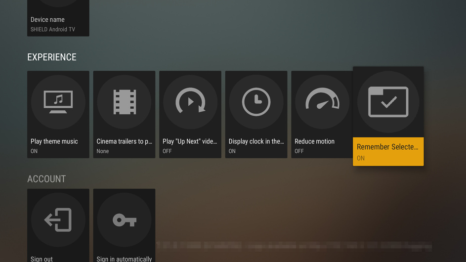

It should be at the bottom right of the settings screen when it is enabled.

The other thing that is very annoying is the sort settings. In the past, I would select how I want the videos sorted and it would remember. Now, every time I successfully get to my content (which is a challenge), the sort option default to their original settings. I can resort the way I want, but why did that change for us as well? I want Plex to remember the settings I choose.

In settings Experience row at the end, enable Remember selected tab it will remain in whatever tab (recommended, library, or collections) you were at last when in that library, and if it was “Library” then it will also remember whatever filters and sorts you had selected.

Thanks. I checked that setting and it was already set to on. So I turned it off and back on, went to the library, changed the filter from sort by title to sort by date added, closed and reopened Plex and it had reverted back to sort by title. So not sure.

The only thing that it isn’t doing, despite the setting “Remember Selected Tab” being set to On, is that it doesn’t remember the sort option I choose. I’m changing it from Sort by Title to Sort by Date Added (it’s for my DVR recordings so I want to see the latest recordings first). But other than that, an almost complete improvement in user experience.

I’m having the same issue on my FireStick 4K. Even with the “remember selected tab” on it will not remember the settings. It’s very frustrating. Is there a fix?
