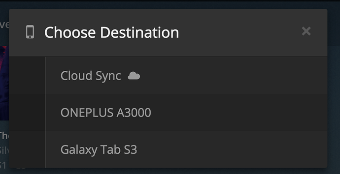

I decided that the fault was the old version of Android. I purchased a new Android TV box from Amazon and I can play again. However, the device still doesn’t show as a syncable option. My tablet and phone are available. I don’t understand why.
Android TV devices are not capable of syncing content to them - most devices have minimum space for content syncing.
