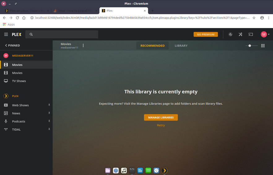

Okay, here’s what I’m seeing. I have no idea why there are now 2 Movie libraries!
There was only 1 before…
Look at the top center of the Window. “Recommended” is showing.
Click “Library” .
Let me know if it changes to your full library contents.
