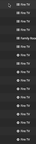

I watched some shows yesterday and they all direct played. ill check again to be sure when i watch something later.
well that the deuce? Running the latest public code. Even in browser is transcoding…quality is junk. Started noticing it a about a week ago, but not sure i have access to previous versions to roll back until I see where it works again.
just checked my history from yesterday today. all direct played except 1 series that the transcodes. Latest public build on the nas. Its a tvs-682
