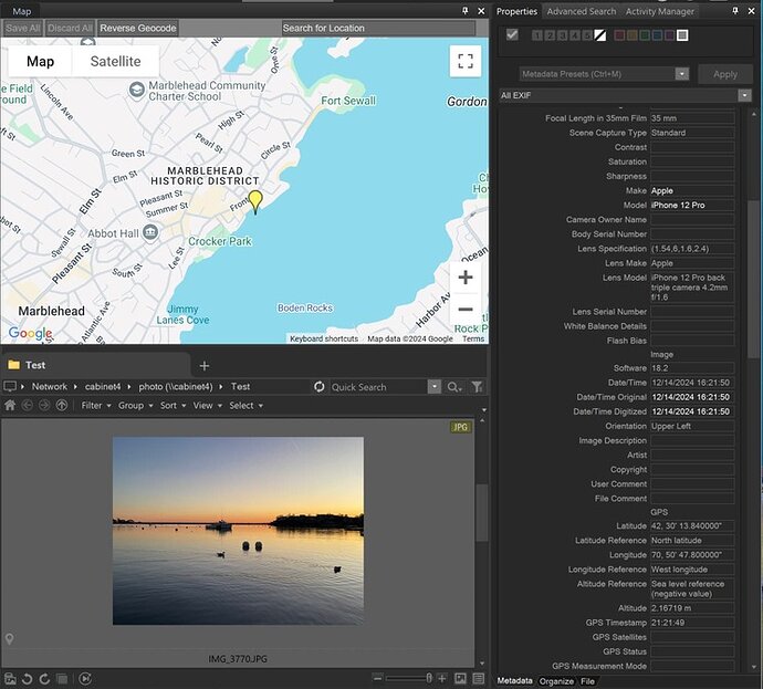

As of the latest Plex version update (v 1.41.3.9292), I have found that the photo EXIF meta data for GPS location is no longer being processed correctly.
Specifically, it appears that a JPEG photo’s EXIF longitude value is being misinterpreted as latitude and the longitude value is being missed entirely and is misinterpreted as “0.0000”. I see this new and incorrect behavior consistently across all of my photo libraries and photos.
Here is an example of the issue…
The below zipped photo (IMG_3770.JPG) has EXIF GPS coordinates, Latitude 42° 30’ 13.840000" North and Longitude 70° 50’ 47.800000" West. (Note - I had to zip it to ensure it retained the original EXIF meta-data)
IMG_3770.zip (1.5 MB)
These are correctly represented in its EXIF meta-data as shown in this ACDSee screenshot (lower right corner). Other photo renderers / editors also show the correct EXIF GPS meta-data.
Plex’s Photo analysis and resulting XML for Geolocation is incorrectly processing EXIF GPS data to be “Coordinates latitude=”-70.84662" longitude=“0.00000"”. See the below screenshot of the XML.
In this example you can clearly see that the real EXIF longitude is being misinterpreted as latitude and longitude is incorrectly being assigned a null value of “0.00000”.

Hi. I am having the same issue : longitude is wrongly set to zero and latitude is set to the longitude in plex. Other tools such as exiftool are seeing the real values :
