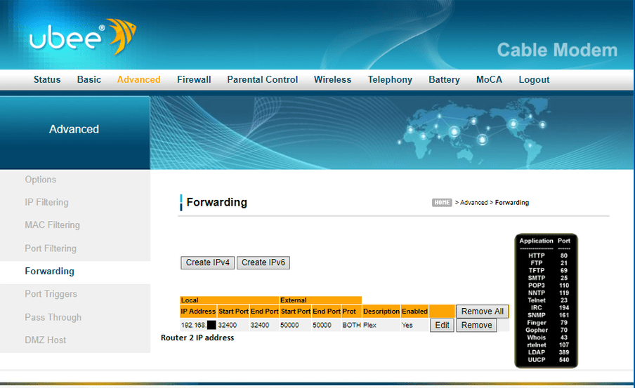

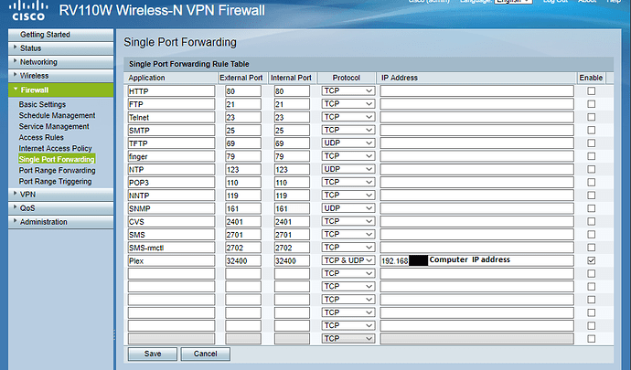

The way I currently have the ports setup is
Router 1:
Router 2 IP
Local Port Start /End: 32400/32400
External Port Start/End: 50000/50000
Router 2:
Computer IP address
The external setting on router 2 is wrong. Since you are forwarding router 1 to port 32400, that becomes the external on router 2.

Router 1:
Router 2:

Router 1 [Ubee] is the modem/router, connected to the internet, given to us by the ISP. Router 2 [Cisco] is the router provided by us at the house.
