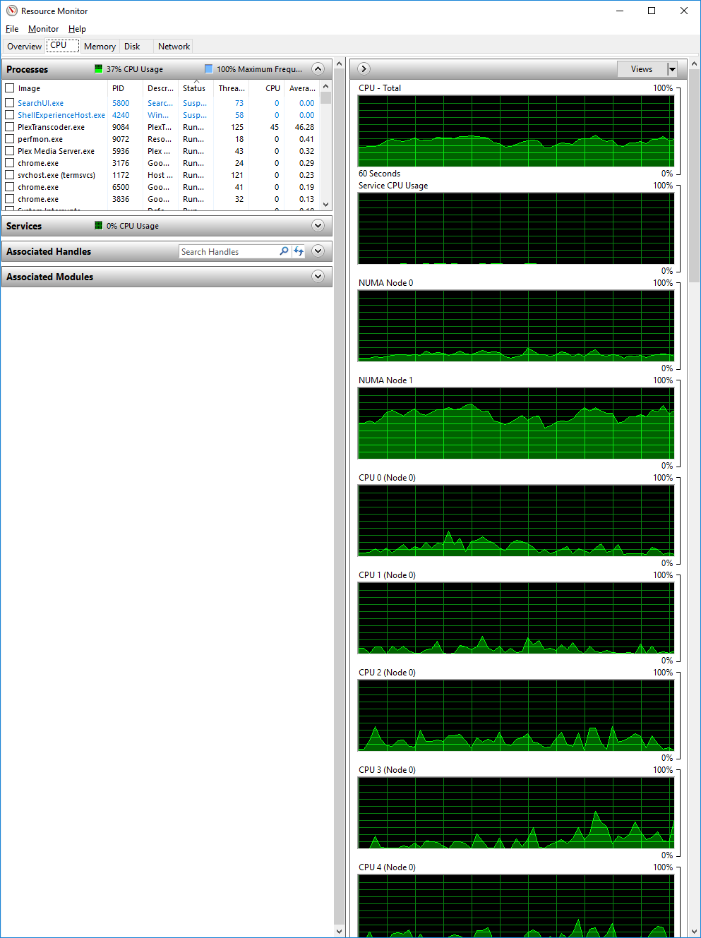

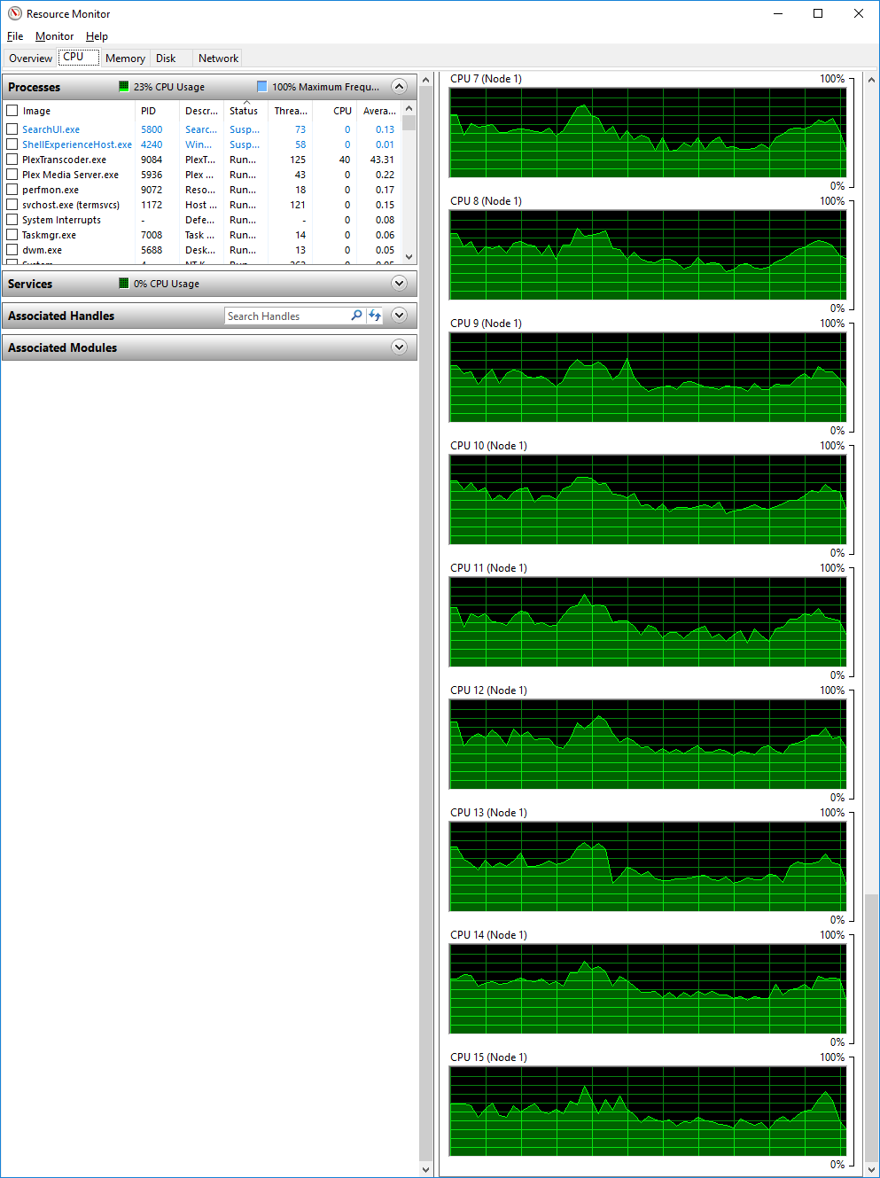

Here are screenshots from task manager during streaming. Even on the 16 threads of a single CPU, it doesn’t seem like I am hitting any limit.
