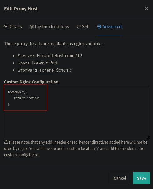

I experienced a 401 Unauthenticated error after setting up nginx a few days ago. It worked the first time and automatically redirected to the sign-in page, but subsequent attempts didn’t work. I noticed that after going through my history, the plex web URL became https://plex.mydomain.com/web/index.html#!. I updated my nginx config to include a custom location (IP and port should be the same as your local host and plex port, typically 32400):
then, I added the rewrite to my location to make sure it redirects to /web/:
After I saved, I tested across multiple devices, cleared browsing cache and tried again, no more 401.
