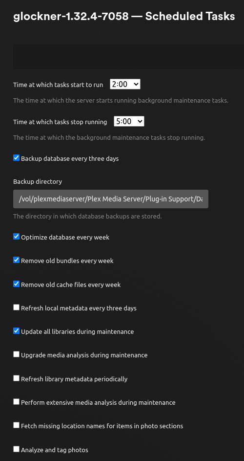

Thanks for the logs with the OP.
I see a lot going on and have some recommendations
  1. Scheduled Tasks
    – Recommend you trim it down
Screenshot from 2023-05-24 11-22-15
  1. Your DB is having problems either due to CPU loading (burning subtitles ??) or just fragmentation which builds over time.

Thanks a lot for the suggestions. I went ahead and made those changes to the Scheduler. Unfortunately, I only have a work computer and it won’t let me download any software, so I won’t be able to run that, but thank you for sharing. I’ll see if it’ll work on my mac and try to go that route. I’ll let you know if it helps tomorrow…Cheers!

I tried changing the parameters to the ones mentioned above, but it still crashed last night. It was some sort of update with Plex that started this a while back.
