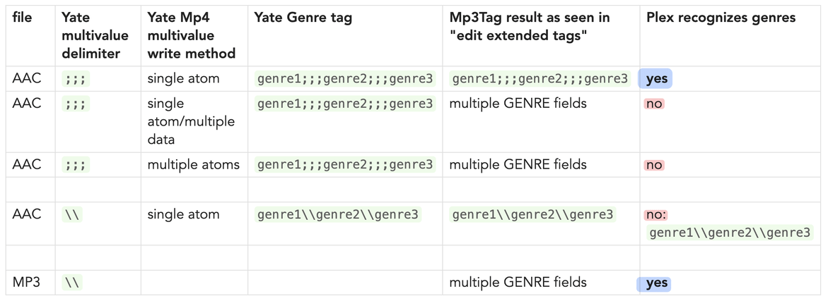

I can write genres separating them with a null character using \\ as separator in Mp3Tag, or With Yate, which allows to choose which character(s) use as multiple values separator in the preferences.
Using MP3 files works both using a null separator, and using ;, multiple genres are recognized correctly by Plex server.
Below some tests done Tagging with YATE anf Mp3Tag.
Yate allows to choose how to write tags with multiple values in one field: single atom, single atom/multiple data, or multiple atoms, which is similar to using \\ as separator in Mp3Tag, which then creates multiple GENRE fields.
Result:
The only way Plex recognizes multiple genres in AACs is when they are written in a single field, separated by one or more semicolons.
Writing multiple fields makes only the last one recognized.
I tried different separators and combinations, tagging using Yate, and reading in Mp3Tag and Plex, and here are some results:

mp3tag doesn’t actually use \\ as a separator, that’s just how they visualise it in their UI. It writes the tag-specific way: null char for id3v2.4, multiple fields for FLAC and MP4.
This whole thing (“Plex does not read multiple values in MP4”) is an ffmpeg bug, by the way, Plex just inherits it because it uses ffmpeg as its tag reading library. You can check this by doing ffmpeg -i file.m4a on a AAC/M4A file with multiple genres (or multiple artists, etc - any field). You will only see the first value.
Background: for 20+ years, ffmpeg would only return the first value of a multivalued tag. A bug report was filed in 2018, 7 years ago. Almost nobody cared, because there were no applications that used ffmpeg for reading tags. This changed about 3 years ago when Plex switched over from its own (I think Python-based?) tag library to ffmpeg, “exposing” the bug. There was finallly a patch applied last year which fixed this for FLAC (Vorbis comments) and mp3 (id3v2.4), but not for the MP4 metadata format.
