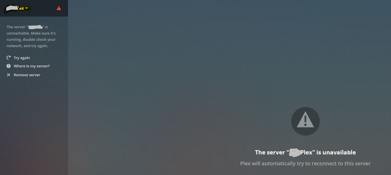

Plex Server every so often is UNREACHABLE!
The only way to work around this is to reboot the NAS device. I have started and stopped the service and it DOES NOT do anything. My experience with PLEX is getting worse and worse! :frowning: is that the cost of growing too big too fast? PLEASE HELP!

I have the same issue, where sometimes it says Plex is unreachable, and I have to try a 2nd time or 3rd. I’ll throw this out there, I have Emby running on the same server and I never have an issue with Emby. I also noticed recently that when the latest version I am using (Version 1.9.6.4429 on FreeBSD 11.1-RELEASE) the login sequence has subtly changed. I always log into my Plex server using https://my-public-ip-address:32400/web. I have never used https://plex.tv. Anyway, I notice now with this version that if you login using public IP address, and watch the URL address bar, you will see that it momentarily changes to plex.tv and then back to public IP address. So, it seems to me, the issue with Plex is its connection back to mothership; it seems to get ‘stale’ and requires a 2nd or 3rd login attempt to wake it up. Emby does not have this, and I never have an issue logging into Emby.
