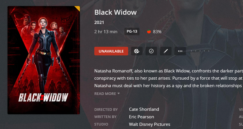

Hi, thanks for the tip, looks like Plex removed the option to do it via then app itself for security reasons. But now I am facing a problem, all my stuff is Unavailable, any idea why ?
Now that you’re pointing back to the original(?) server data directory… do the media directories still match (e.g. same drive letters etc.)?
You can click on the Edit icon (pencil) and check the Info tab to see under which path Plex is looking for that file.

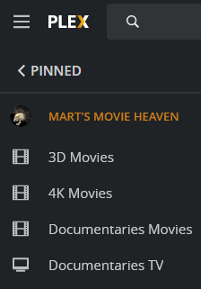

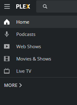

Ok, well my bad. Formatting changed my drive letter so I only had to change that, now it’s fine BUT…Now I am having another problem. My server just shows up on my local network and it looks like it’s another server completely. If you look at the screenshots it’s like I have no server and it has been added to my pinned servers.
Capture1
Capture2
The libraries in Mart's Movie Heaven don’t seem to be pinned – though I might be wrong if the pins got truncated :wink:
Given this is a new install (that happens to point to your old data directory), Plex will treat it as such. Therefore you’ll need to re-pin your libraries in the different clients.

Everything is ok, my server is online and all is green. If you look at the screenshots it looks like plex added my local server to the pined servers I have. First screen shows that I have nothing in Home server but I do have it in my pined servers.
Capture1
Capture2
You might have it backwards here. When you click on MORE, you see all servers.
If you click back you see your pinned media sources. (this is the default view)
Currently you don’t have any libraries from your own or shared servers pinned.
So you could do that now.
or, as indicated above, perform the Reset Customization procedure to go again through the first-time setup wizard – which may speed up the process of pinning all the libraries.
