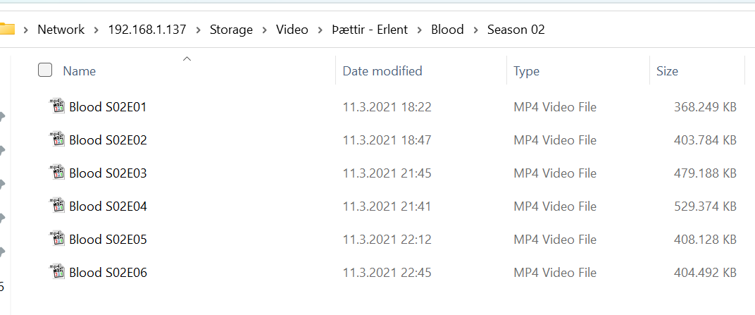

Please show a screen capture of your file system, from the root of your Show library, all the way down to the episode missing
Also please state the OS your PMS is running
Plex server is 1.28.1.6092 running on TrueNAS Core 12.0
I assume, that the root of your show Library is pointing towards Video\Pættir - Erlint ?
And first of all, you are not following the naming std!
Blood has so many matches, so you need as a bare minimum to change show folder to:
Blood (YEAR)
Edit: See https://support.plex.tv/articles/naming-and-organizing-your-tv-show-files/
Ok, i thought the (YEAR) naming scheme was only for movies. I did change this now and it solved the problem. Plex now finds Season 01. Thank you very much for your help. :slight_smile:
