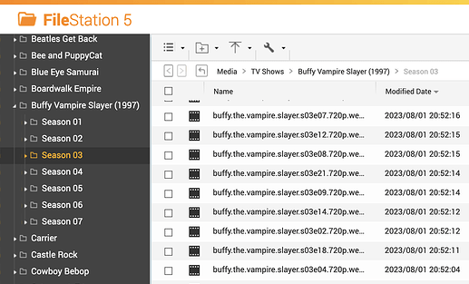

There might be some misunderstandings in what is being expressed and what is being assumed so being simple and clear - even if it sounds “too simple” - might help out here and personally I like screenshots to help in those cases. :slight_smile:
Can you provide a screenshot or two of the files as they are on the server - like the folders and naming?
For example, here’s mine for Buffy:
You can see enough detail to see the full path, folders and episodes.

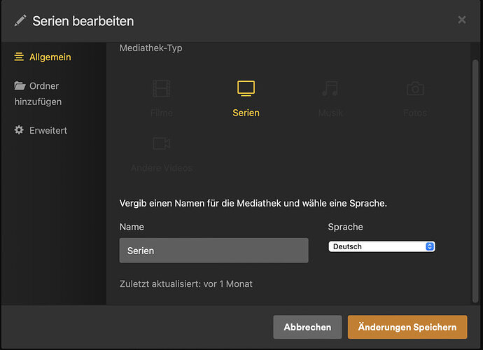

Can you provide a screenshot or two of how you have your TV Library setup in Plex?
I get to it usually via the three dots on the Library in Plex home:
Here’s showing library type in Plex:
Here’s showing the mapped folders:
You can see the mapped folder matches my screenshot of my files.

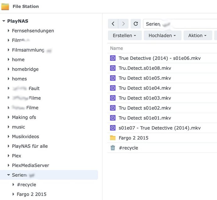

Hi Insomnic,
sorry, that it took so long for my reply. I hope you still want to help me.
So you say screenshots would be better? Ok, that is a good idea.
Here are the screenshots you may need.
naming
Edit
mapped folders
Hope you can help me. Obviously the Plex guys won’t do anything for me.
You have been pointed to the relevant naming guides 3 times already.
Your screenshots are telling that you are still ignoring them.

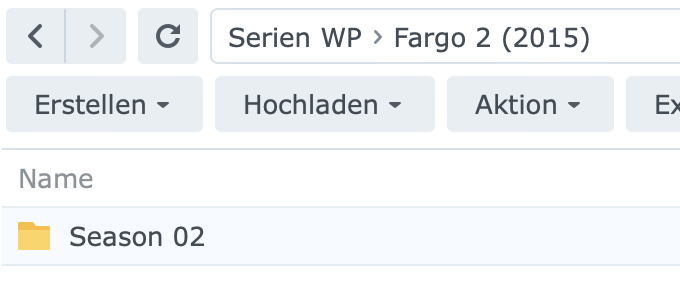

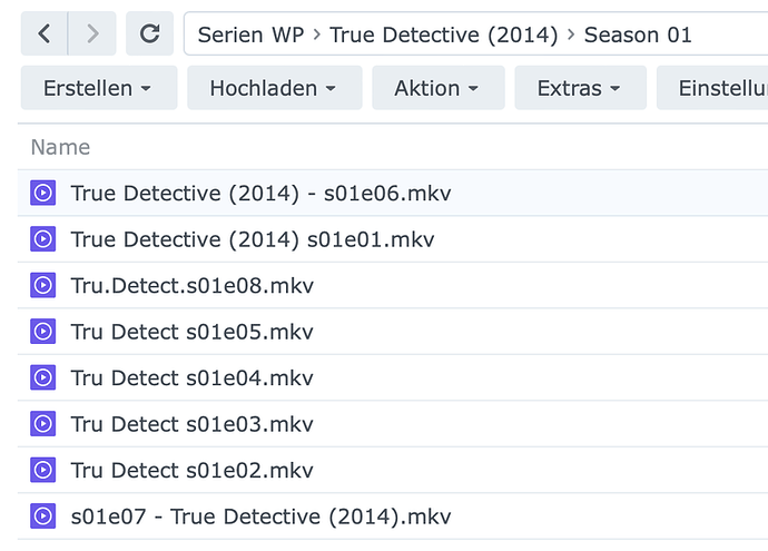

Hi FordGuy61,
thx for your help. I tried to make everything as you said, nothing went to the better. I, again, send you the screenshots that you can see it yourself.
Any other idea?
Thanks and regards
Alex
No, you did not. “Fargo 2 (2015)” is wrong. “Tru.Detect” is wrong.
Rename all the folders and files following the Plex documentation or the example in my earlier post.
Then Plex Dance the show, to clear the old names/matches from the Plex database.
Do I understand you right, that if I put “wrong named” files inside the right folders, Plex still don’t find any? Not even right named ones?!
So I now deleted everything else from the folder but True Detective, as you see in the screenshot. What is still wrong?

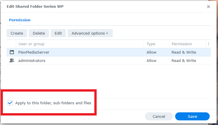

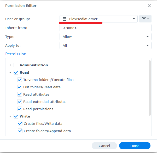

Now configure folder/file permissions so Plex can see the files.
With DSM 6, the user Plex must have at least read only permission to the media files.
With DSM 7, the user PlexMediaServer must have at least read only permission to the media files.
I’m writing this for DSM 7. Adjust for DSM 6 if needed.
Please follow the procedure even if the file permissions already seem correct.

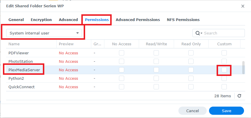

  1. Login to Synology DSM. Username must have administrative rights.
  2. Control Panel → Shared Folder
  3. Edit the Serien WP shared folder.
  4. Select Permissions tab.
  5. Change Local Users to System Internal User (Not applicable for DSM 6).
  6. Select user PlexMediaServer (If DSM 6, select user Plex).
  7. Check the box for Custom permissions.
    This opens the Permissions Editor.
  8. For Read-Only, select all the Read permissions.
    For Read-Write, select all Read & Write permissions.
    Administration permissions are not needed.
    Click Done.
9. IMPORTANT
You will be back at the Edit Shared Folder window.
Check the box to “Apply to this folder, sub-folders, and files.” and Save.
DSM will then update the permissions for all folders and files in Serien WP.
  1. If another Edit Shared Folders window is open, Save to close it.
    Close the Control Panel.
  2. Plex should now have permissions to see the files in Serien WP.
    Rescan the library to pick up your media files.
