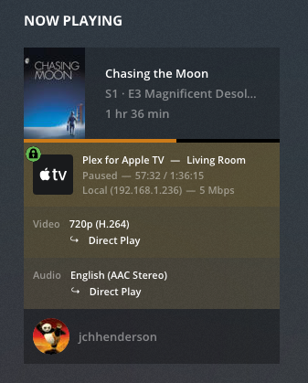

In your screenshot above, it says LOCAL but has a non local ip address.
If that is your internet WAN ip, then I would guess that plex is confused and transcoding because it is not on a 10.x or 192.168 ip address.

However, my AppleTv is on my internal network, and its real IP address is here"
32
Why would Plex think my Apple TV is remote when it is local? That would be forcing it to transcode as I have limited my remote stream bitrate:
48

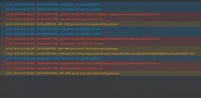

I got nothing from filtering by “MDE”. These are the logs I did get…
Do you think the NAT: PMP error is relevant?

possibly, it sounds like plex server is not able to do the port mapping.
