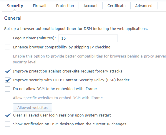

There’s this section as well. I don’t know what the cross site forgery would have to do with this though.
