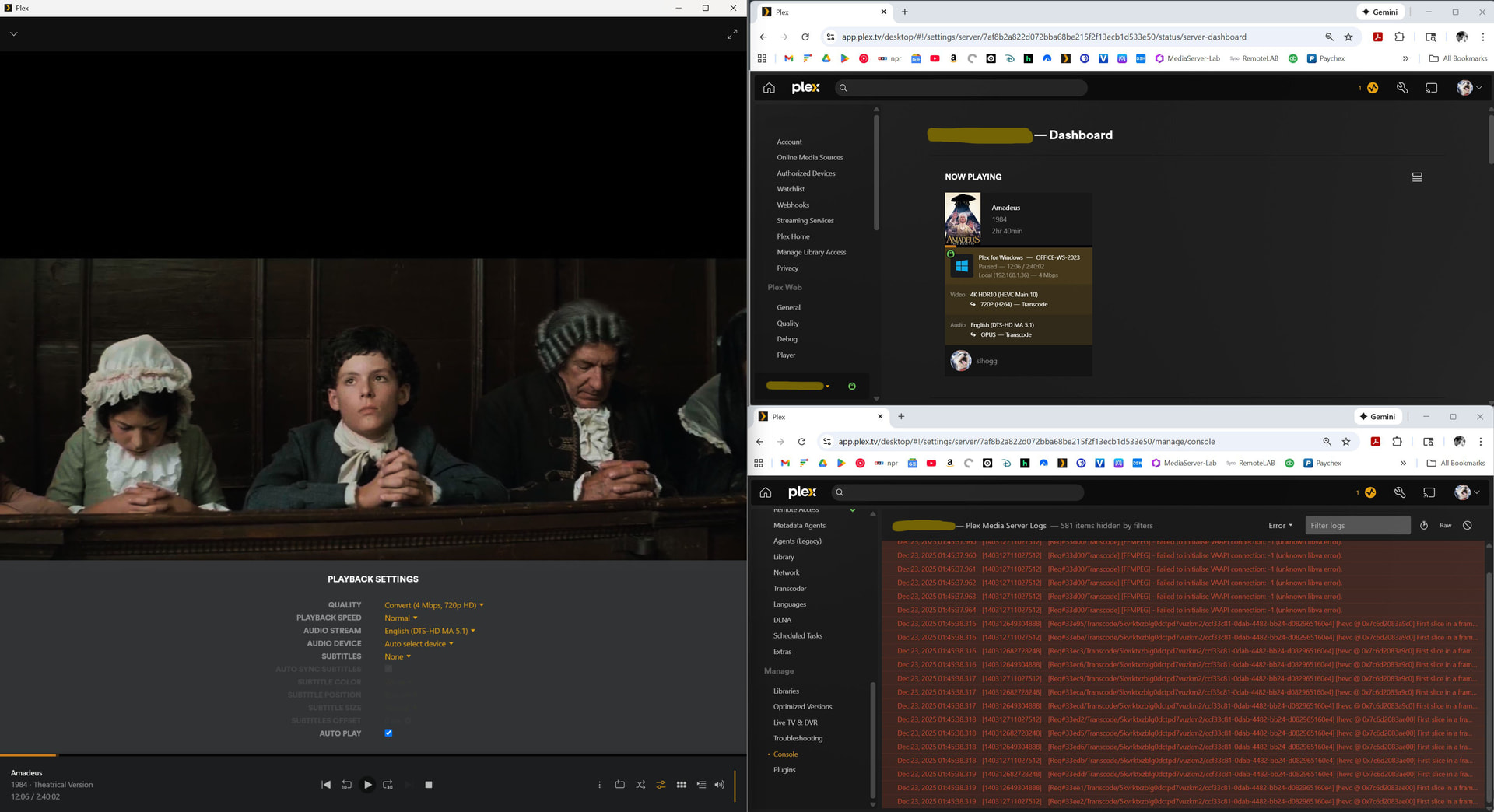

Understood - this was a ChatGPT troubleshooting suggestion, but I now see that mixing system glibc-based VAAPI libraries with PMS’s MUSL-built stack will always cause symbol resolution failures. I appreciate the explanation — that makes complete sense.
Okay, I did a quick uninstall / reinstall using the dpkg (screenshots attached below) and I am still running into the FFMPEG error.
Confirmed version Installed:
Removed PMS cleanly using “sudo dpkg -r plexmediaserver” and Verified that /usr/lib/plexmediaserver was removed:
Ensured I was installing the correct build:
Reinstalled using “sudo dpkg -i /home/slhogg/plexmediaserver_1.43.1.10350-71a2c3fa9_amd64.deb”:
PMS starts normally again after the reinstall, but the Plex transcoder still fails with “Failed to initialise VAAPI connection: -1 (unknown libva error) Device creation failed: -5” and falls back to software transcoding via the CPU:
I want to genuinely thank you for taking the time to prepare the TrueNAS commands — I’m looking forward to trying them. Since the Arc DG2 GPU is passed through via PCIe and is working correctly at the OS level, it feels like we’re very close to getting hardware transcoding running on the A40 GPU, and your insight has been incredibly helpful.
Thank you again for all your time and assistance!
