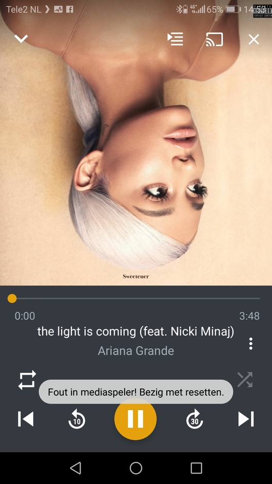

Is that the Android player? It appears to be
Yes, i used windows & linux as server, clients are apple tv, android, ios, smart tv with tizen etc. The photo is about the issues related with android player with windows server…

Here I have some logs, but for some reason plex is now not accessible outside the network, while it was all the other times playback did not work. Plex Media Server Logs_2018-08-24_13-54-14.zip (4.6 MB)
I think this tells me that plex refuses transcoding, but I do not know why?
It is in the Transcoder log without number…
<Stream albumGain="-10.26" albumPeak="0.999023" albumRange="4.683442" bitrate="32" bitrateMode="vbr" channels="2" codec="mp3" displayTitle="Unknown (FLAC Stereo)" gain="-10.69" id="34631" loudness="-7.31" lra="2.57" peak="0.880859" selected="1" streamType="2" decision="transcode" location="direct" />
Anyway, the playback l stopped around 13.53u and about 45 seconds on August 24.
And then there is an issue with 4k playback, the above is all related to music playback. Music that doesn’t start playing at all.
