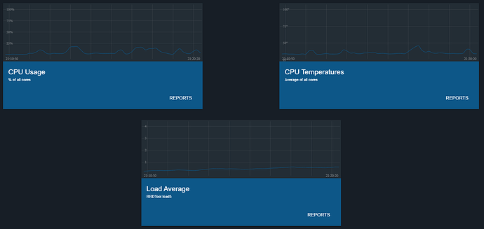

Ideal is below.
CPU usage: 0.56-1.5%
CPU Temperatures: 33-37C
Load Average:0.26-0.30

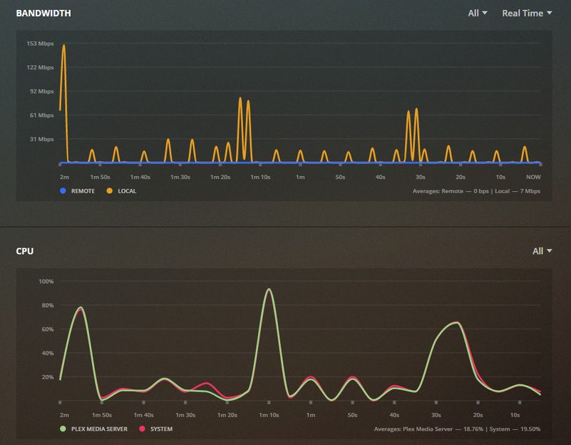

This is what I’m getting with the Plex Phone App. Still high for a single stream because I was getting these kind of numbers or less with 4 streams running at the same time but it’s a better experience then it is through Chrome. I haven’t tried with Roku.

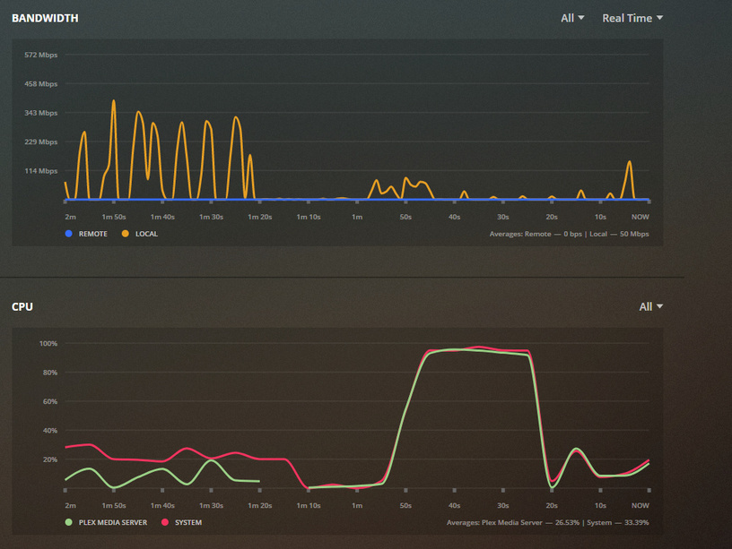

The first picture from the dashboard is from the first file and jumping around in that file for the first half and the second half is just starting up the second file not even jumping around. Second/Third picture is just regular streaming from the second file.

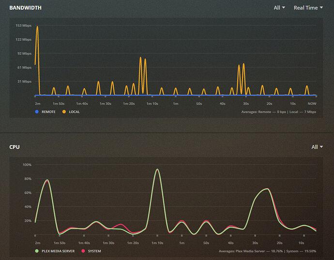

This is what it looks like playing the second file through the Plex phone app. First picture is jumping around and the second is just streaming without jumping around.

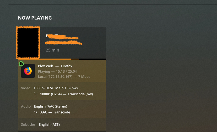

the graphs are relatively useless.
post the picture of the now playing section (above the graphs) so we can see what is being direct played/streamed/transcoded and whether HW is used, what codec, and whether the client is local or remotely connected.
like
click image to e expand the details if needed
This was the video in question. I just updated to the version relased yesterday and some of the videos that wouldn’t play at all are now able to play. Still issue with High CPU but it’s better and now I can at least somewhat confirm that it’s probably the transcoder. What do you think about the picture Tenkojunky? pahi78 I tried by changing the audio to that and it’s still the same thing.

When transcoding video it is expected to see a high CPU utilization. However, when you first posted you were streaming to your phone. And according to the server logs you were only transcoding the audio-stream while the video-stream was just copied. This is called “Direct Stream” and @mikec_pt pointed it out to you.
The screen shot you posted suggests you are streaming to Chrome. Please repost an image while you are streaming to your phone. You should see lower CPU-usage, and also please try to keep AC3 as the audio stream. It will however issue a transcode, since your phone announced it can only support AAC as the codec, but I believe AC3->AAC is more kind to the CPU than the high bitrate TrueHD codec.

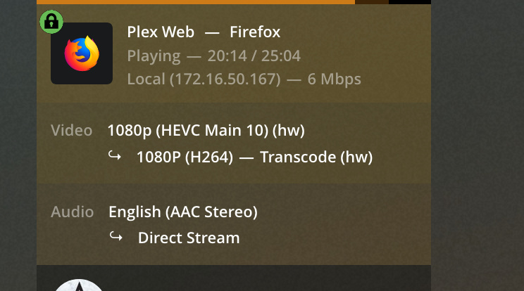

In any case if you can post screenshots of the dashboard (please include the stream info, not just the cpu graphs) and we find you’re bumping into a scenario where things should work better than they are, we can also look into that. This paired with logs make it easier to check, feel free to DM if you don’ want to public share those, and even so you can hide sensitive info like media names and IPs, I just need the codecs, quality and bandwidth, ie.:
^ Direct Stream is disabled there, but now in this one (I also turned off subs I just wanted yo to see the difference in the audio stream) :
actually I missed you’re post here:
Direct Stream is likely disabled here, we should copy the video since the browser supports H264, and the Audio is converted to AAC, this shouldn’t be extremely expensive on the CPU. Another reason is if you have subs and they need to be burned in, but the screeshots doesn’t show subs!
