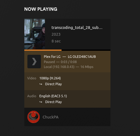

2021 LG C1 here – Direct Play
Screenshot from 2023-03-06 10-53-19
Screenshot from 2023-03-06 10-55-19

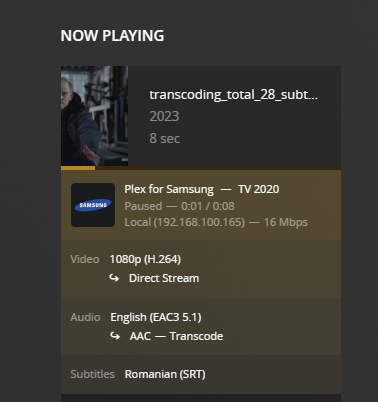

Here are the DEBUG logs you asked for: fe9na - Ghostbin
And also check this how it looks for me:

My C1 just updated firmware. I can confirm I still have DirectPlay
Screenshot from 2023-03-06 12-11-15

Please note that I have the same issue with a 2020 Samsung TV, another 2021 Samsung TV and an LG OLED B1 (2022 or maybe 2021).
Again, as I can’t stress this enough: Why should Plex do this Direct Streaming (audio transcoding) if the TV on its own (without Plex) is perfectly capable of playing the MKV file? It surely sounds like a bug on Plex’s side to me.

Bottom line – Manage your media and discard (remux out) those tracks you don’t need if you want DirectPlay. If you don’t mind the Remux (it takes VERY little CPU) then leave it be.
There is no PMS failure here.
As an alternative, you can place the SRT files externally. PMS will mux them in as it plays
And for you personally it truly makes sense that it works fine via USB (no 30 tracks limit there) but the limit just gets triggered over Plex?
Because for me it’s still a bit unclear.
I was under the impression that Direct Playing = same as USB playing
