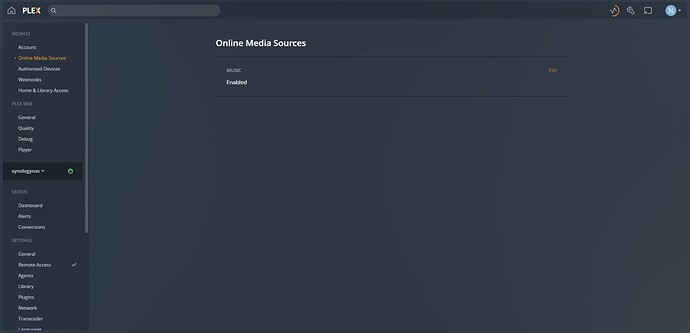

Whilst moving my Plex server from the Synology package to a docker container, I had a chance to look into why I am only able to see and enable “Music” as an online media source in "Settings->Online Media Sources. I haven’t been able to see Movies or TV for quite a long time now.

It is blocked because of regional regulations there. You can disable them at https://app.plex.tv/desktop/#!/settings/online-media-sources
https://support.plex.tv/articles/frequently-asked-questions-vod/
No. I can’t as only “Music” appears there.
sorry i forgot to reply to this. does seem like a bug the logs are filling up with that if you cannot access. I don’t have an ETA for a fix though
Thanks @BigWheel. No biggy.
Hello @BigWheel . please let us know if you found a fix to enable the online media sources … currently can only see music there enabled similar to the earlier shared screeshot.
