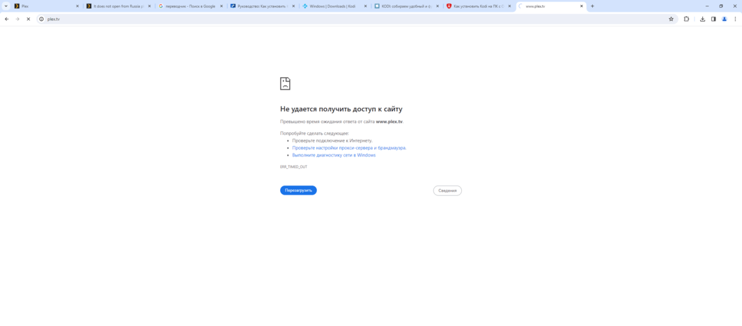

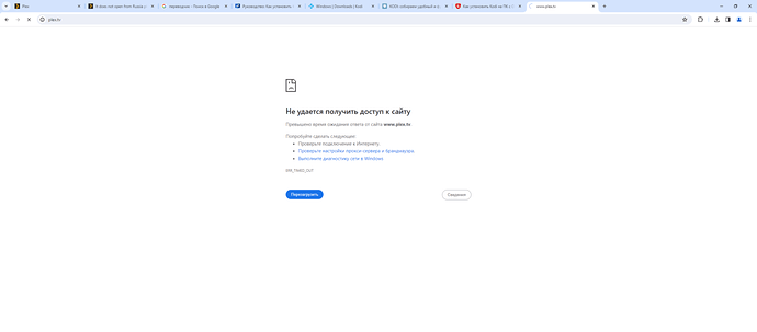

starting from 03/31/2024, the site does not open https://plex.tv(34.248.180.89) and https://support.plex.tv(188.114.99.224)
As a result, it slows down the opening of the application, local media content and it is impossible to compare the media library with the movie database.
At the same time, the site https://forums.plex.tv/(plex.hosted-by-discourse.com - 184.105.99.43) opens, authorization takes place - it works.
Please clarify - is plex no longer available for us Russians?

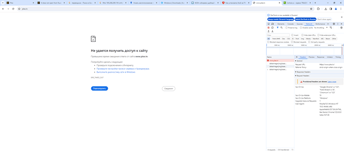

Standard methods for solving problems do not produce results (including changing DNS).
Only logging in through ProxyServer(VPN) helps.
I contacted my provider - the verdict was that access was blocked due to the provider’s liability.
Tacert, in my case:
traceroute to plex.tv (52.213.10.112), 15 hops max, 60 byte packets
1 ovzhost49.vps.reg.ru (89.108.69.63) 0.050 ms
2 *
3 146-192-212-88.host.exepto.ru (88.212.192.146) 6.222 ms
4 252-192-212-88.host.exepto.ru (88.212.192.252) 0.310 ms
5 msk-m9-b1-ae30-vlan342.fiord.net (62.140.239.222) 0.763 ms
6 stk-tct-b1-ae5-vlan531.fiord.net (93.191.9.185) 18.249 ms
7 99.83.119.236 (99.83.119.236) 55.588 ms
8 52.93.144.88 (52.93.144.88) 19.489 ms
9 52.93.144.63 (52.93.144.63) 22.664 ms
10 *
11 *
12 *
13 *
14 *
15 *

I have access to 5 different internet providers. Everywhere the same error. The site is unavailable. I was able to log in to Samsung TV only with VPN enabled
Can confirm. Only opens via vpn

nope, whole https://plex.tv does not
what about https://www.plex.tv (the “www” can make it behave differently)
same((

No www.plex.tv doesn’t work here in St.Petersburg, Russia. Access is only possible via VPN. Remote access is also through VPN only. HTPC on the local network works fine and interestingly enough Plexamp works as usual with no restrictions

Regarding the use of addresses:
https://www.plex.tv/
https://plex.tv/
http://www.plex.tv/
http://plex.tv
plex.tv
www.plex.tv
, - does not give results.

Trace route to plex.tv [52.213.10.112]
with a maximum number of jumps of 30:
1 1 ms 1 ms 1 ms 192.168.50.1
2 * * * The timeout period for the request has exceeded.
3 4 ms 4 ms 4 ms 77.37.250.192
4 4 ms 4 ms 4 ms 87.226.221.70
5 19 ms 20 ms 19 ms mskix.amazon.com [195.208.208.225]
6 * * * Request timeout exceeded.
7 * * * Request timeout exceeded.
8 * * * Request timeout exceeded.
9 * * * Request timeout exceeded.
10 * * * Request timeout exceeded.
