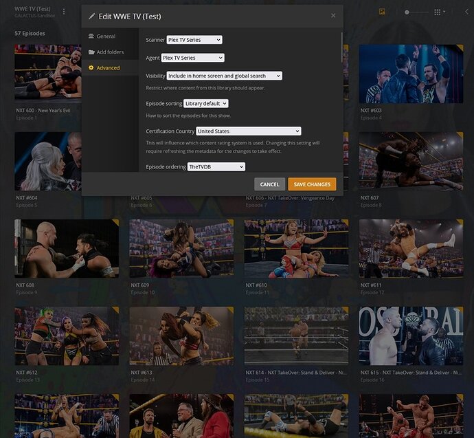

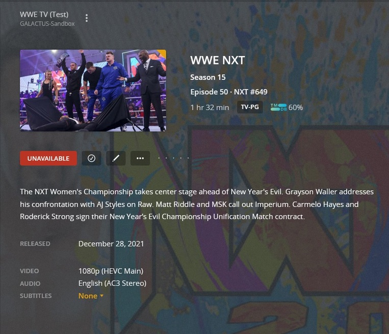

I’ve attached four files as a reference.
Ignore the unavailable. The files were moved out of the test folder, but the metadata remained. As you can see, TMDB is listing #649 as 12/28; while the proper one pulls the same info as well…
Could this be file naming convention? Or is it something else… or am I just going to have to deal with it.

@tom80H - Ok, completed my testing utilizing the following:
Naming Format:
{Series TitleYear} - {Air-Date} - {Episode CleanTitle}
Focusing on the individual show’s Advanced Settings
Default - No Change (Even when swapped from TMDB or TVDB in Library settings)
TMDB - Pulled metadata from the site properly.
TVDB (Aired) - Pulled metadata but only changed the last six episodes. All episodes before were still under TMDB metadata format.
TVDB (DVD) - All metadata gone. Only had “Episode 1”, etc.
TVDB (Absolute) - All metadata gone. Only had “Episode 1”, etc.
I haven’t changed the physical naming convention yet back to:
{Series TitleYear} - S{season:00}E{episode:00} - {Episode CleanTitle}
To see if that should make any difference.
Thoughts?

If I were watching the show singularly, this wouldn’t be an issue; but I have it a part of a SMART PLAYLIST that utilizes the Release Date.
So because of the issue, both Episodes 50 & 57 are listed as 12/28/21 per the pictures above.
What it should be is E50 NXT 649 (There’s also no “#”, that format is used by TMDB), and it should be released on 11/16/21.

Okay, so it’s the date that is wrong on one of the episodes then.
I did a bit of digging and I’m not sure what to make of this, as this exact episode (#649) exists on both TMDB and TVDB but they have different air dates, and this trend continues with I think most of the episodes in this season (same episode titles but different air dates). It’s possible they are using different network’s air dates.
I’m not sure who has the correct date here but by default we’ll use the date from TMDB. So if you think that this date is wrong, then the best thing to do would be to submit corrections on www.themoviedb.org.
